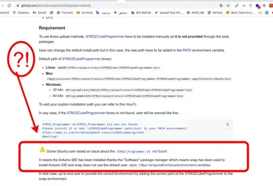

so can not see the port connection on the Arduino which has been installed by snap as you can see below :

  • ST-LInk may not be recognized as ttyUSB and it is normal. You have to find specific guide for setting up ST-Link on Ubuntu. As starting point you can use [this document](https://github.com/stm32duino/wiki/wiki/Upload-methods). For more reproducible results please install Arduino IDE [using ubuntu-make](https://askubuntu.com/a/1025755/66509) and remove snap version (if any). – N0rbert Jun 13 '21 at 16:17
Based ofN0rbert Comment,The problem exist by snap version of Arduino which is said here:
