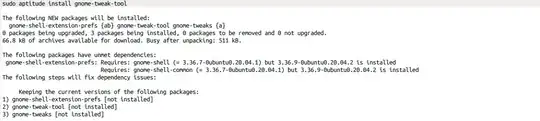

A solution using aptitude:
$ sudo apt install -y aptitude
$ sudo aptitude install gnome-tweaks
The following actions will resolve these dependencies:
     Keep the following packages at their current version:
1)     gnome-shell-extension-prefs [Not Installed]
2)     gnome-tweaks [Not Installed]
Accept this solution? [Y/n/q/?] n
     Downgrade the following packages:
1)     gnome-shell [3.36.9-0ubuntu0.20.04.2 (now) -> 3.36.4-1ubuntu1~20.04.2 (focal-security)]
2)     gnome-shell-common [3.36.9-0ubuntu0.20.04.2 (now) -> 3.36.4-1ubuntu1~20.04.2 (focal-security)]
Accept this solution? [Y/n/q/?] y
The following packages will be DOWNGRADED:
  gnome-shell gnome-shell-common
The following NEW packages will be installed:
  chrome-gnome-shell{a} gir1.2-handy-0.0{a} gnome-shell-extension-prefs{a} gnome-tweaks
0 packages upgraded, 4 newly installed, 2 downgraded, 0 to remove and 0 not upgraded.
Need to get 1,022 kB of archives. After unpacking 599 kB will be used.
Do you want to continue? [Y/n/?] y
You can then install other packages normally, such as sudo apt install -y gnome-shell-extensions.
