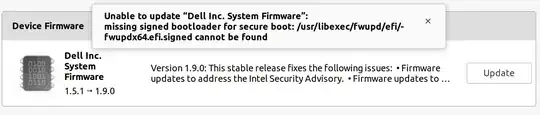

I have a Dell XPS 13 7390 BTX, running Ubuntu 20.04. I've noticed this error when updating my programs, specifically "Dell System Firmware 1.5.1 > 1.9.0".
The closest to a solution I found is from https://github.com/Foxboron/sbctl/issues/10#issuecomment-648442565, recommending:
sbctl sign -s /usr/libexec/fwupd/efi/fwupdx64.efi -o /usr/libexec/fwupd/efi/fwupdx64.efi.signed
I did so and the output was:

Update
The problem persists but when I click "update" a message box appears saying an update has been installed and a restart is required:
... and then a few seconds later an error message shows up showing a failure in downloading repository information (the internet connection is fine):
