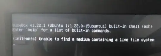

Idecided to install Ubuntu on my Mac Mini, and delete the macOS partition. While installing Ubuntu 20.04 on my Mac Mini 2018 model A1993 I came across some errors and the installer wasn't able to finish. The first fatal error was grub-install '/dev/nvme0n1' failed. Then I ran Boot-Repair and it showed that Locked NVRAm is detected. Also the paste URL was indicating that Both primary and backup GPT are corrupted. Try making a fresh table and using Parted's rescue to recover partitions. Can anyone guide me in the right direction? This is my first time doing this type of install.
Error 1:
Error 1
Error 2:
Error 2

karel
  • 110,292
  • 102
  • 269
  • 299
euffi
  • If you ran boot-repair, you must have already had some problem you were trying to fix. Can you edit your question and include more details and context about the problems you are experiencing? – Nmath Dec 19 '21 at 04:52
  • Boot-Repair would not corrupt partition tables. It primarily runs grub updates or grub installs and other standard commands to document system. As it suggests you may need parted rescue to try to recovery partitions. Do you have partition table backup or other documentation on what partitions you have? Parted rescue seems easier than testdisk https://askubuntu.com/questions/665445/upgraded-to-windows-10-on-dual-boot-and-cant-boot-to-ubuntu-partition Used parted rescue https://ubuntuforums.org/showthread.php?t=2362656 & https://www.gnu.org/software/parted/manual/parted.html#rescue – oldfred Dec 19 '21 at 15:21
  • @Nmath I edited my questions and included more info and pictures of the errors. – euffi Dec 19 '21 at 15:48
  • Doesn't make sense IMO to run boot-repair when all you're trying to fix is an installation that was not successful to begin with. First I would make sure that your motherboard BIOS is up-to-date. Refer to the documentation and support for your motherboard to do that. Then, *before installing* - you should format your hard drive as GPT. You can do this using "Disks" in the live session (Try Ubuntu when booting from installation media). Formatting will create a new partition table. Then you should be able to install Ubuntu. Let us know if this works for you – Nmath Dec 19 '21 at 20:56
I've stumbled upon the same issues while installing Linux Mint - it seems grub can't write to NVRAM in the MacMini (no clue what that means, just repeating what I read), and thus it needs to do stuff a bit differently.
Then, you have two options:
igorsantos07
  • 630
