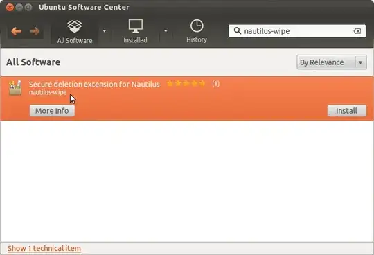

The easiest option I could find with your requirements is nautilus-wipe.
  • Go to the Software Center, search for nautilus-wipe, and install it.
