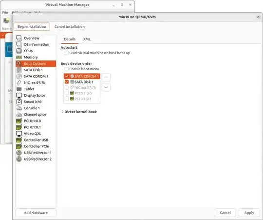

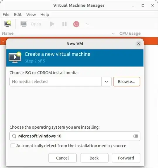

STEP 13. Use VirtManager to create a new guest machine
Install KVM
$ sudo apt-get install qemu-kvm libvirt-daemon-system libvirt-clients bridge-utils
Add user
$ sudo adduser username libvirtd
If you have group issue "adduser: The group `libvirtd' does not exist." try:
$ sudo addgroup libvirtd
Install VirtManager
$ sudo apt-get install virt-manager
Create new guest machine with a custom configuration.
$ virt-manager
If you get a "make sure the libvirtd daemon is running` error, reboot and try again.
Image 01
Image 02
Image 03
Image 04
Image 05
Image 06
You must:
  1. select the "Q35" chipset and "UEFI
    x86_64:/usr/share/OVMF/OVMF_CODE_4M.ms.fd" firmware or similar
Image 07
  1. add PCI Host Devices** for GPU passthrough
Image 08
Image 09
Image 10
  1. set QXL video driver and SPICE client for display with "Address"
    listen type.
Image 11
Image 12
Image 13
