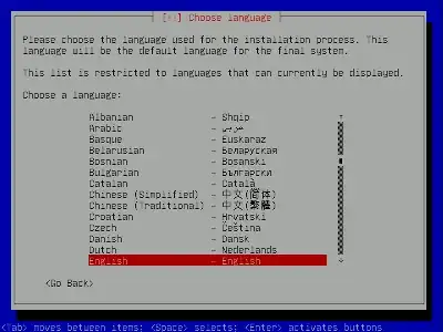

If you don't mind an installer that looks a bit dated, is a tiny bit harder to use, you could try the Alternate Installation disk.
Downloads: alt text 32 bit iso / alt text 64 bit iso
This method of installation uses far less resources, which always helps when something's wrong. Also, if this installation hangs as well, you can press Alt+ and Alt+ to see some system log messages*, which might point you and us to what's wrong. (You should be able to do the same on the normal Live installation, using Ctrl+Alt+F1..F7, but I'm not sure whether it's the same business).
* press those any time, even while things are running, you can always go back.
