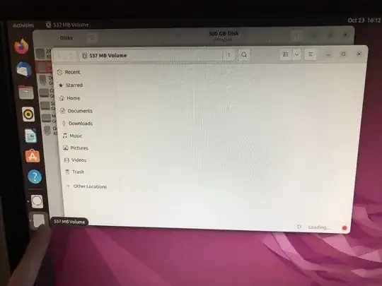

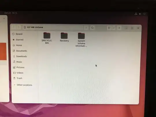

It seems that the First partition can be mounted and opened:
mount 1
It take a moment to load but here is what I see:
mount 2
