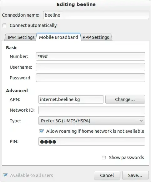

You can store the PIN in the configuration, then network-manager won't ask for it again.
Graphical Way
Open Network-Connections, go to tab 'Mobile Broadband'
Screenshot, Network-Connections
Click 'Edit' and go again to the tab 'Mobile Broadband'
Screenshot, Mobile Broadband
Enter your PIN here, then it shouldn't ask for it again.
