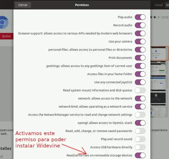

Ubuntu 20.04 (snap Chromium)
(This information can also be found in the original article: https://que-cosas.blogspot.com/2020/04/ver-netflix-en-el-chromium-de-ubuntu.html)
1º We download Chrome to use its Widevine.
We can do it by means of the following command, which will provide us with the .DEB file where we will find the desired Widevine folder.
wget https://dl.google.com/linux/direct/google-chrome-stable_current_amd64.deb
Then we will decompress it in a folder that we will name tmp.
dpkg -x google-chrome-stable_current_amd64.deb tmp
2º We changed the permissions of the Chromium snap pack.
As it's installed, there is a read/write permission on disks that does not allow us to make changes and therefore does not allow us to install Widevine. We can change it from Ubuntu Software (the snap shop).
Permissions snap Chromium 1
Permissions snap Chromium 2
