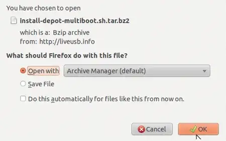

Here I got something, taken from pendrivelinux.com
First, install the Multisystem LiveUSB Tool
  1. Download and Open the Script with Ubuntu's Archive Manager
    Open
  2. Extract the install-depot-multiboot.sh Script to your Desktop
    Extract
    Desktop
  3. Double Click install-depot-multiboot.sh from your desktop and select the option to Run in Terminal
    Run
