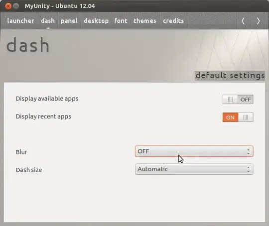

Deactivating the "blur" effect might help.
To do so install "MyUnity" in the Ubuntu Software Center. Then you can disable the blur effect by setting the "Blur" option on the "dash"-tab to "Off".
Here's a screenshot: window screenshot showing disabling of blur effect
