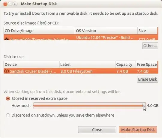

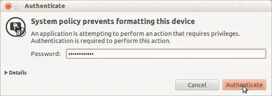

Free up your Pen-drive by using Erase Disk button. After finish, there will be an option to set the space that will be used on your pen-drive.
Open Startup Disk Creator
Select Pen-Drive and click Erase button
Click Yes when prompt
Put your password
Wait a lil bit and you will get an option to adjust the extra space.
If it still doesn't work, remove your Pen-Drive and reboot your system.
