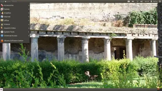

If it looks a bit like the picture below then you've probably booted into Gnome classic. When you're logging in after starting your computer there are options for which desktop environment you'd like to use (where these are depend on which desktop manager you use but should be near your username - if you're using lightdm just click on the logo to the right of your username). Set that to gnome instead of gnome-classic and you're done.
gnome-classic screenshot
