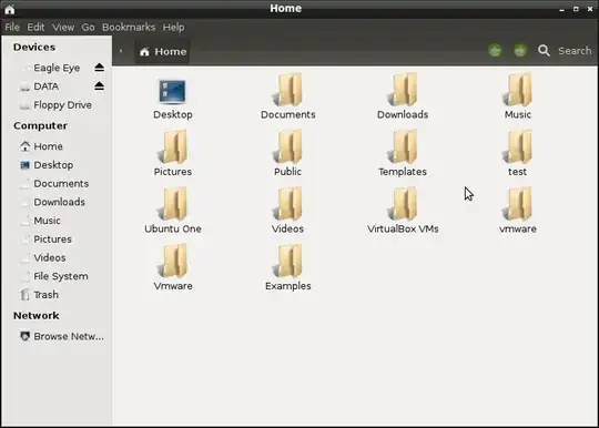

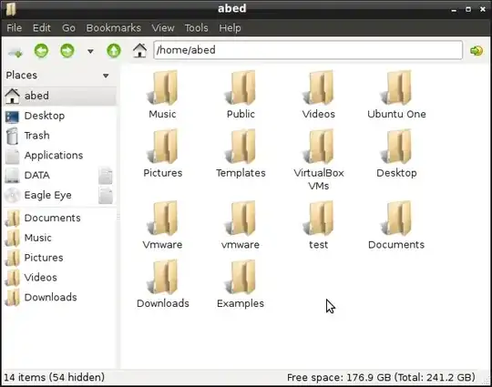

When you open file manager you get
enter image description here Now go to Menu --> Accessories --> File Manager --> right click, and choose properties
Change pcmafm to nautilus and you will get
