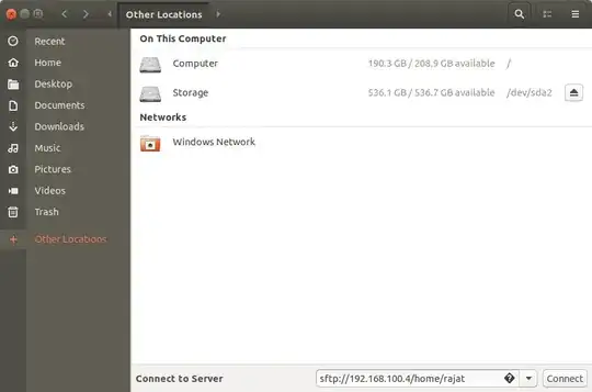

You can achive this securely via SSH, you need to install openssh-server on the host machine from which you want to access the files use following command to install:
sudo apt install openssh-server
Get your local ip address of system which has files you want to access
ip address show
if connected to wifi pick 3: wl01 or in case of Ethernet pick 2: enp3s0
you are done with host, move to the system form which you want to access, open file manager (nautilus) and chose Other Locations at the bottom notice connect to Server input box
Enter
sftp://<the_IP_of_the_server>/home/<username>
and press connect, you will be asked username and password of the user of which files you want to access
Rajat
