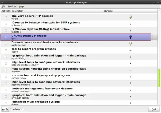

To disable GDM:
Install bum Install bum.
After installation it will be found under System>>Administration>>Bootup-Manager
Uncheck Gnome Display Manager alt text
