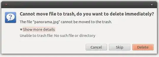

How can I delete a file that is there but the system says is not there?
Permissions tab - tried changing it, but it would reset itself automatically This is what happens when I click "Delete"

Looking at your screenshots I see you have the group set as root. I'd try using chown and see if it fixes the problem.
sudo chown -hR [username]:[username] /home/[username]
Replacing [username] with your username.
You'll get a couple errors.
example
mywebslave
  • 754
  • mywebslave, I did what you suggested, showed me the same 'Permission denied' as in your screenshot. Still can't delete the damn file. – Valeriu Sep 27 '12 at 20:48
