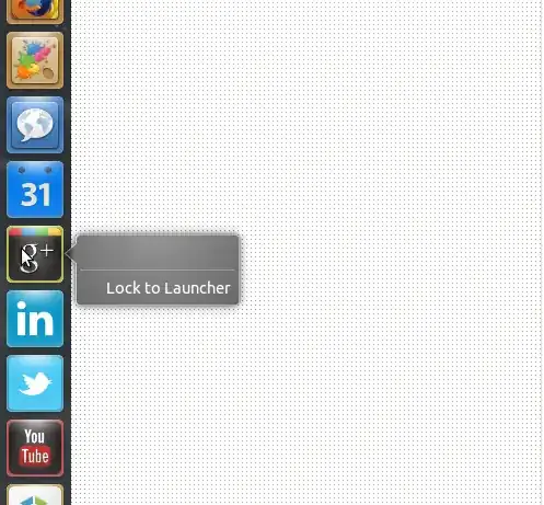

Today my launcher looks like a long vertical bar of icons. I have 14 webapp icons on the launcher but there is no option to remove them or an option to no include them (Or even an option to merge them as I asked in a previous question). Is there an option, without having to disable the whole webapp idea, to remove individual webapps from the launcher.
Forgot to add that the option to Unlock from Launcher does not appear, but only on the webapps. On the rest of the launcher icons it appears correctly.
This is an image of the actual problem (Thanks to koma):

The above two solutions do not work.
As mentioned above there is no option to 'unlock from launcher', unless you have previously locked the icon to the launcher.
As i understand it, locking to the launcher means that the icon will show up regardless of whether the webpage is open or not. If it is unlocked it will disappear when the webpage is closed and reappear when it is opened.
However to remove the icon from the launcher, so that it does not appear regardless of whether you visit the webpage you have to uninstall the relevant webapp from the software centre.
  1. Open software centre
  2. search for the specific web app eg."unity-webapps-gmail" or "unity-webapps-googledocs"
  3. Click uninstall
Answer is here:http://askubuntu.com/questions/166655/how-do-i-remove-a-website-from-ubuntus-web-applications?rq=1
