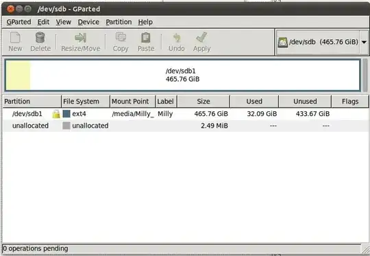

GParted also reports the correct size of the external HDD.
alt text
