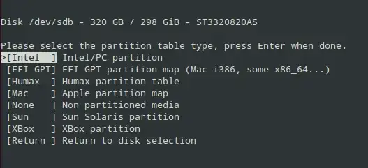

After installing ,open Terminal and run sudo testdisk to get this
Select the create to create new log file ,select the Hard disk you want to recover , Proceed upon selecting the Disk
Then select the Intel option , Enter to proceed further.

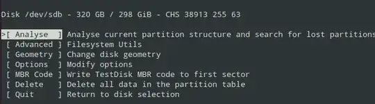

Analyse to search for Lost Partition
Then it will list the Current Partition Structure , select the Quick search option to list the Deleted partition .
If Found Nothing then select the Deeper search option to list the deleted partitions. It will probably list all the partitions created since the Disk was First used. You have to be extremely careful here.
For more in-depth instructions refer this Step-By-Step guide .If found proper listing of partitions , select the Write option and Reboot to see the changes. Best of Luck .
