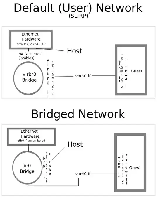

The default network mode is the User mode, also called SLIRP. It uses a predefined virbr0 bridge which is NAT routed to the guest computer. The NAT routing uses the kernel's ip_forwarding feature and iptables. Bridge mode uses a virtual bridge in the guest to which the (unnumbered) Ethernet interface connects, and on which both the host and the guest have their network interfaces.
The following diagrams may make the differences clearer:
Network diagrams
You can see how the default User network is defined with:
virsh net-dumpxml default
I can set up the bridged mode with the following approaches:

Note that both the virtual machine's vnet0 interface and the eth0 interface are connected to the br0 bridge.

Note that the br0 interface connects my host computer to the same bridge being used by the guest.
You can check that you are bridged rather than NAT routed to your own network by using traceroute 8.8.8.8. If the first node is your network's router rather than the guest's ip address your network should be working correctly.
