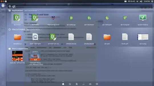

Next We open up Qt Creator,

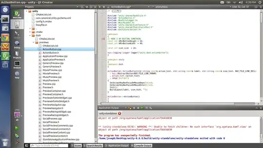

If all goes well it should set up build files to ~/Desktop/build as shown in the screen-shot
We can now Press the Finish Button. And We will get a screen that looks like this.
Now to build Unity and test are results. The first thing that we need to do is tell Qt-creator what we want to run after compile. We do this by clicking in the Icon that looks like a monitor and then select
unity-standalone
NOTE: There are some issues with unity stand alone and it will not run as fast nor will it render graphics as good as when installed. But when you install on to system all will be ok. I am also unsure when Unity started using Unity-standalone as before 5.10 I was a Unity 2d kinda guy :)
Now we can Run Unity press ctrl+r (keyboard shortcut) to run and Unity will compile.
Or we can press the green arrow button also in QT-Creator to Run
Well Compiling (Running) We can watch to see what is going on by pressing the
Compile Output Button
Once compile is done (takes a minute) Unity-Standalone should launch
Now we can play around with the Unity that we just built Go back to QT Creator and and Press the stop button. To Kill Unity-Standalone
Next we can start editing files if we like to make Unity more how we like
After editing we press ctrl+s to save are work then Run it again ctrl+r
