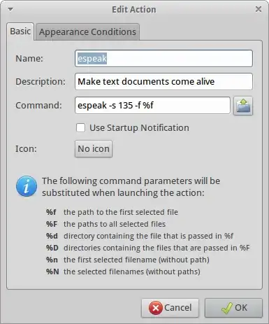

You would create a new custom action by clicking the add button (shown in the first screenshot). Then you would put the below command, for example, in the command box (like I have done for a different example in screenshot 2):
zenity --question;if [ $? = 0 ];then srm -rvf %F;fi
and then make sure that the correct file types were selected in the Appearance Conditions menu (as I have done for a different example in screenshot 3).
The command above uses srm (which is in the package called secure-delete), and one should be very careful in using it on files. Hence, the GNOME dialog program, Zenity, is often used if confirmation is needed for the actions (like it was used here) so that files are not removed accidentally.
However, to use a safer example than srm, we can use the example of espeak, so that we can get espeak to read any text file to us. We would create a new custom action and then we would put in the command box (as in screenshot 2)
espeak -s 135 -f %f
Espeak needs to be installed if it isn't already (with sudo apt-get install espeak); the -s option I have used just slows down the speed of the speech a bit; you can specify other parameters as well like different voices, but the -f switch must always go before %f as it shows espeak the text input file to use.
