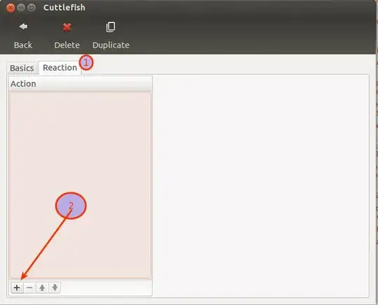

  4. Click on the reaction tab and click on the plus sign on the bottom left: enter image description here

  6. Now, on the right, you can see that you can select an executable to run with any parameters you wish, so, you have to let Cuttlefish run on the system tray and it will run your command each time a USB device is plugged in: enter image description here
I assume that you know a command which you can use in order to send your email. If not, please post it as a comment so as to include it into my answer.
