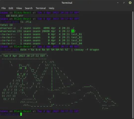

I realize I'm a little late to this party, but by setting PS1 in $HOME/.bashrc like so:
PS1="\e[1;38;5;56;48;5;234m\u \e[38;5;240mon \e[1;38;5;28;48;5;234m\h \e[38;5;240mat \e[1;38;5;56;48;5;234m\[\$(date +'%a %-d %b %Y %H:%M:%S %Z')\\] \e[0m\n\e[0;38;5;56;48;5;234m[\w]\e[0m "
I get a full-colour-formatted, time-stampped prompt like so: terminal screenshot
Here's how it breaks down:
  • \e[1;38;5;56;48;5;234m\u is the colour-coded username, where \u would be just the username
  • \e[1;38;5;28;48;5;234m\h is the colour-coded hostname, \h is the hostname
  • \e[1;38;5;56;48;5;234m\[\$(date +'%a %-d %b %Y %H:%M:%S %Z')\\] is the colour-coded full-date-and-time insert in 24-hour time where [\$(date +'%a %-d %b %Y %H:%M:%S %Z')\\] would be the same, but monochrome, and, alternatively, you could just use \d to print the date in your default system format
  • \n moves to the next line
  • [\w] shows the current working directory encased in square brackets
If you want solid tips for using colour codes, I used this guide as a reference for my colour codes.
