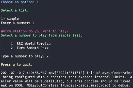

Tera
I'm the author of Tera, an interactive terminal music radio player.
  • 27780+ radio stations powered by Radio Browser API.
  • MPV, a free, open-source, and cross-platform media player.
  • CRUD favorite lists.
  • Play from a list
  • Search radio station by tag, name, language, country code, state.
  • Save a station to a list after playing.
  • Delete a radio station from a list.
  • I feel lucky menu.
  • Gist upload.
Installation
Either you clone the repo, use HomeBrew, install via deb package, or you can use Awesome package manager.
Usage
After installing Tera, you just need to run tera to run the program.
screenshot
screenshot
You can find more details here. Other options here.
