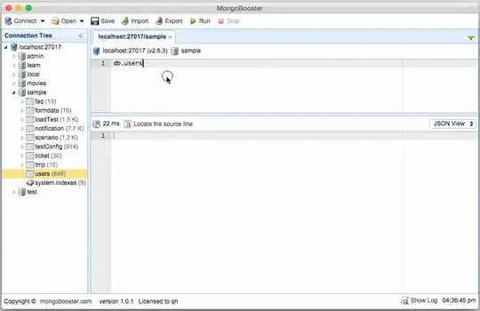

You can check out mongobooster. MongoBooster is a shell-centric cross-platform GUI tool for MongoDB v2.2-3.2, which provides update-in-place, Lodash & Moment.js integration, ES6 syntax support and true intellisense experience.
MongoBooster has the following features:
  1. MongoBooster offers true IntelliSense experience. The build-in language service knows all possible completions, methods, properties, variables, key words, even the MongoDB collection names, field names and operators. The IntelliSense suggestions will pop up as you type.
  2. In the script editor, parameter hints will pop up as you're typing a method invocation.Handy date range snippets, SQL to MongoDB conversion snippets...
  3. The mouse hover will show many useful information, such as types of symbols, function definition, type information and document.
  4. Matching brackets will be highlighted as soon as the cursor is near one of them.
  5. Everything MongoBooster can do is in the Command Palette. See it by using shortcuts CTRL-SHIFT-P
  6. SSH tunneling for MongoDB connections
  7. Simple management of shards and replica sets
  8. There is a free license with some limitations.
Disclaimer: I work for MongoBooster.
mongobooster_main_screen
QingHai
  • 193
  • I downloaded this tool and ran one aggregation with it. It failed (No documents returned). Next! I don't have time for tools that hit bugs inside of 5 minutes. The aggregation worked fine in Robomongo incidentally. – jcollum Aug 31 '16 at 15:39
