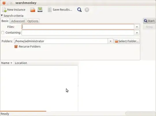

81
You can use searchmonkey. The tool is available in the repositories, so you can simply
sudo apt-get install searchmonkey
On the other hand, command line search with grep is really intended for that...
Here is a screenshot from searchmonkey
