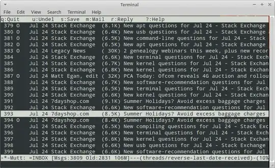

A screenshot from the newly compiled program (showing some older, non-personal emails):
