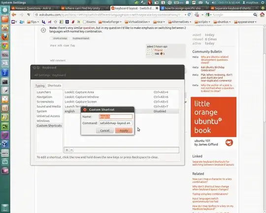

Remove languages from keyboard layout
Then From Dash choose keyboard settings and then click on shortcuts then add custom shortcut
choose a name and command similar to this
setxkbmap -layout en
Then click on the "Disabled " on the right to make you shortcut lets say Alt+Shift+1
Do it again for other languages you want

    you can do that also with answer above. Remove the third unused language from keyboard layout so you can use ctrl-shift with lang1 and lang2. Then create a shortcut for the third with the above answer. so you can user ctrl-alt for switching between lang1 and lang2 and the created shortcut for lang3 –  Oct 13 '12 at 10:14
    Check the updated asnwer –  Oct 13 '12 at 10:21

  • For me it worked, but I had to use `en_US` instead of `en` (`setxkbmap -layout en_US`). – Michal Vician Apr 24 '15 at 08:43
