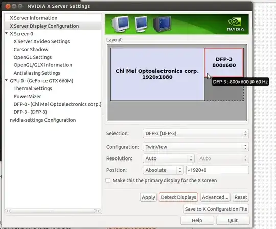

Anyways, the monitor works beautifully with my Ubuntu desktop which has an nVidia card with DVI output. However, I am having problem using this monitor with my laptop. After some searching around I found a few posts suggesting to use an active adaptor for mini display port, so I went and bought a mini display to dual link DVI-D adaptor.. When using this adaptor the monitor is recognized by nvidia-settings tool but with incorrect resolution information.
As you can see the monitor is incorrectly recognized and there are no other resolution available to set. This post on ubuntu forums and this other post on overclock both suggest that the monitor is reporting corrupt EDID file. I have tried following their instructions, but so far I have not been able to display any image on the monitor from my laptop.
The laptop I am using is an ASUS G75VW with a 1920x1080 screen. It has a VGA, an HDMI 1.4a, and a mini display port. The graphic card is an nvidia gforce gtx 660M with 2GB dedicated memory. I am running Ubuntu 12.10 on here which I upgrade from 12.04 a few weeks ago.
As I said I have tried several suggestions, including specifying Modeline in xorg.conf and also linking to EDID files I found from those forum posts above. However, I am not sure if the EDID files I found are suitable for my monitor. I think the solution to my problem consist of obtaining the EDID file of my monitor and then fixing it and modifying xorg.conf to force nvidia driver to load the correct resolution. However, I am not sure what steps I need to take to do this.

I had a similar problem recently. I could've made a custom Xorg.conf file but that would've undermined all the nice new automatic configuration when I connected to other monitors.
I re-wrote the corrupted EDID instead:
Here are some reading materials: ref: https://en.wikipedia.org/wiki/Extended_display_identification_data#External_links
edid-rw: https://github.com/bulletmark/edid-rw ( this might work for you... I tried it and could read the edid but couldn't write?! Try it first?)
You need to find the monitor's i2c address:
i2cdetect -l
// look for vga, in this case I got "1"
i2cdetect 1
// look for address.. in this case only one.. I got 0x50
sudo i2cdump 1 0x50 b
// get the current edid
I found a listing on the internet for my monitor's edid as part of an xorg listing in a bug post. Put it in file new.bin:
Checksum!.. This next line should spit out 0
x=$( sum -s new.bin | cut -d " " -f 1 ); echo "$x % 256 " |bc
Since edid-rw above didn't work for me I looked into:
I used this to write the edid:
WARNING - DANGEROUS - Make sure your i2c addresses are correct and insert them below!
cat new.bin | hexdump -v -e '"sudo i2cset -y 1 0x50 0x%_ax 0x" /1 "%02X b\n"'
check final result:
(make sure to use the address info you found above using i2cdetect instead of " 1 0x50 ")
sudo i2cdump 1 0x50 b >test.bin
cat test.bin
x=$( sum -s test.bin | cut -d " " -f 1 ); echo "$x % 256 " |bc should return 0 if good
