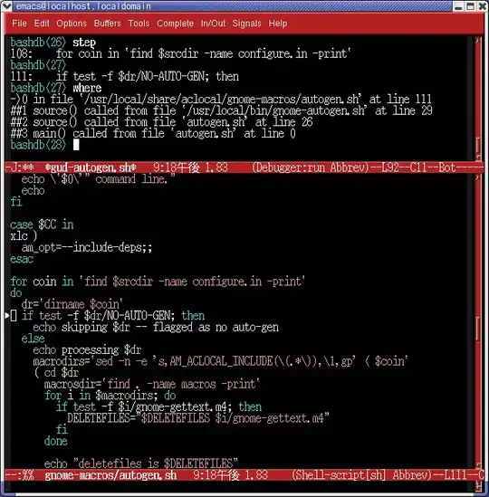

21
Yes, there is Bash Debugger Project.
You can also use set -x and set -v at execution. More info:
http://www.linuxtopia.org/online_books/advanced_bash_scripting_guide/debugging.html http://www.cyberciti.biz/tips/debugging-shell-script.html
Good luck!
