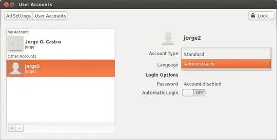

You can also use a graphical interface. Click on the gear on the top right of the panel, then select "System Settings" and then "User Accounts"
You need to click the little unlock button to be able to edit things in this window. Then click on the person's account and select the proper dropdown for "Account Type"

    I have Ubuntu 10.10 but my graphic interface is someway locked. It opens but I when buttons are pressed nothing happens. I suppose is something related to the privileges (I'm actually sudoer). How can I solve this issue? – linello Jan 18 '13 at 09:49
  • Did you click the 'unlock' button? – daboross Jun 10 '13 at 02:22

Its really simple if you are using Unity as your desktop environment.
If you have created a user already then you can simply change it from Standard to Administrator, else make sure that you selected Administrator when creating a new one.
Don't forget to unlock before trying to change it
