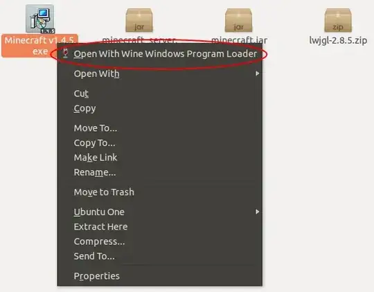

If you are like me and had the game first on Windows then install the game using Wine (No need to buy it again).
After installation is finished, the game should have created the .minecraft folder in /home/USER/.wine/drive_c/users/USER/Application Data. To go there simply open DASH and type the C letter. If you have wine configured already, the Browse C: Drive icon should appear. Click on it. From here on go to users --> USERNAME (Depends on your Ubuntu user) --> Application Data.

  • @Sergey - Thanks, anyway for me, when I download the minecraft.jar and try to execute it it always gives me a problem. – Luis Alvarado Dec 04 '12 at 21:34
  • Instead of using a .exe launcher/downloader to get the minecraft.jar, you can just download it from: [Here](http://s3.amazonaws.com/MinecraftDownload/minecraft.jar). You don't need anything more than that jar and lwjgl to run minecraft, all the other files are created/downloaded automatically (Even if you haven't bought the game). Note that that's the url from which the official launcher downloads it. – mid_kid Apr 16 '13 at 21:19
  • @mid_kid Thanks for the info and yes, I added that. That is why around the middle it splits into the one you are mentioning (Which is the one am using after Marco told me about it) and the other one I had previously which was actually an exe that did the installation and such. – Luis Alvarado Apr 16 '13 at 21:34
