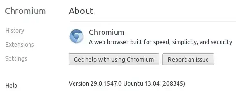

If you already have it installed then simply do a sudo apt-get ugprade instead of installing the package again. Your end result should be something like this:

trunk Chromium
As a note, you can use this version of Chromium as a portable version on more Linux systems.
