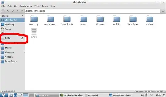

  2. Solution in /media/username:
    • In terminal:
      $ sudo mkdir -p /media/username/
      Or, in my case:
      $ sudo mkdir -p /media/christophe/
    • Double check before rebooting:
      $ ls -l /media/
      total 4
      drwxr-xr-x 3 root root 4096 Dec 26 04:25 christophe
      $ ls -l /media/christophe/
      total 0
    • Edit /etc/fstab (for example $ sudo nano /etc/fstab) and add the line:
      UUID=your_uuid_value  /media/christophe/data       ext4    defaults        0       2
    • Reboot
    • Double check after rebooting:
      $ ls -l /media/
      total 4
      total 4
      drwxr--r-- 2 christophe christophe 4096 Dec 26 04:31 data
      $ ls -l /media/christophe/data/
      total 4
      -rw-rw-r-- 1 christophe christophe 6 Dec 26 04:37 2.txt
    • Conclusion: It does work AND it does indeed appear as a media in file manager (nautilus, PCManFM, ...) [see file_manager.png]file_manager.png
