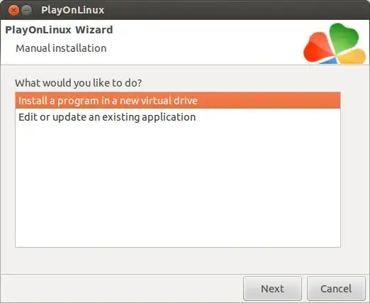

While installing an application you have an option of installing it a new virtual drive, in which you can install a different version of wine.
Virtual_Drive
