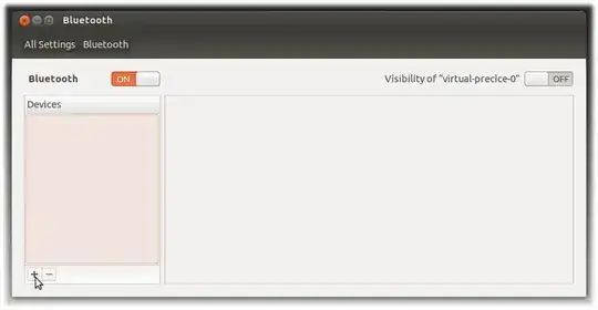

  1. Open the Bluetooth setting by clicking on the Bluetooth symbol on the top panel:
  2. Choose + in the bottom left corner of the following window:
