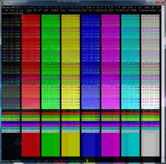

Here is my solution with Bash only:
for x in {0..8}; do
    for i in {30..37}; do
        for a in {40..47}; do
            echo -ne "\e[$x;$i;$a""m\\\e[$x;$i;$a""m\e[0;37;40m "
        done
        echo
    done
done
echo ""
One-liner:
for x in {0..8}; do for i in {30..37}; do for a in {40..47}; do echo -ne "\e[$x;$i;$a""m\\\e[$x;$i;$a""m\e[0;37;40m "; done; echo; done; done; echo ""
Here's a picture in Cygwin:
Cygwin screenshot

oktay
  • 1,504
    FYI, `{30..37}` is equivalent to `\`seq 30 37\`` in bash and is faster. – Barry Kelly Dec 16 '15 at 05:18
    @BarryKelly: good tip, thanks. just tested and as you noted: it's really much faster!!! :-) so here is the new one: `for x in 0 1 4 5 7 8; do for i in {30..37}; do for a in {40..47}; do echo -ne "\e[$x;$i;$a""m\\\e[$x;$i;$a""m\e[0;37;40m "; done; echo; done; done; echo ""; ` – oktay Dec 17 '15 at 11:56
  • Will this work on a Mac ? – code-8 Feb 10 '17 at 15:13
  • @ihue See if this answers your question: [Simple Tricks to Improve the Terminal Appearance in Mac OS X](http://osxdaily.com/2013/02/05/improve-terminal-appearance-mac-os-x/). For more details, check http://AskDifferent.com – wjandrea Feb 12 '17 at 00:56
  • Sample code did not work on MacOS but the python answer worked. – sorin Jul 03 '17 at 09:42
    This also works on macOS, just replace `\e` with `\033`. – Atika Dec 06 '19 at 08:59
