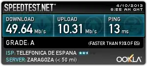

I'm not an experienced user but as you can see in the image.:
speedtest image
I've got the same connection.
That happened to me while using an old Ubuntu version, and the problem was that my computer wireless USB adapter was 802.11g. When I change it to 802.11n the problem was solved (its possible you only need to adapt the drivers).
I know that with your computer knowledge this could be a stupid answer, but consider my intereset on helping.
