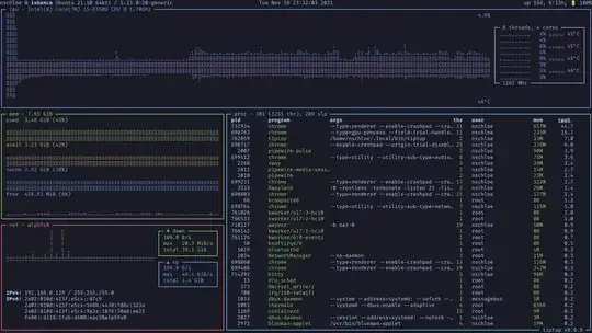

I recently publishes tiptop, a system monitor for the command line.
The exact coloring depends on your terminal's theme. (This one is Tokyo Night.)
