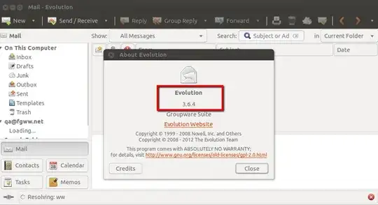

This will install Evolution 3.6.4. To install it, just press Ctrl+Alt+T on your keyboard to open Terminal. When it opens, run the command(s) below:
sudo add-apt-repository ppa:support-bec/evolution
sudo apt-get update
sudo apt-get install evolution
Once done you will get:

  • Can i install it on top of the old version? Or i need first to uninstall the old version? Thanks. – amrfaissal May 25 '13 at 15:20
  • I tried it and it worked, but **with no data**. I have to say, just to be safe, backup your data, and then restore on 3.6.4, if anything goes wrong. – Mitch May 25 '13 at 15:26
  • Ukh it gives this when i try to update: Failed to fetch http://ppa.launchpad.net/support-bec/evolution/ubuntu/dists/precise/main/source/Sources 404 Not Found !! – amrfaissal May 25 '13 at 15:36
  • I got the same error, but it installed OK. – Mitch May 25 '13 at 15:40
