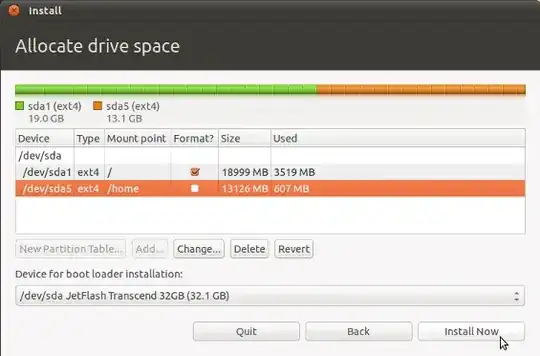

After having chosen Something else the graphical partition manager GParted will guide us through the partitioning process:
  • At this point take extra care that the boot loader Grub indeed will be installed to the USB drive (/sda in the picture, but yours will be different) and not to anywhere else
See the bottom of the image above, and make your selection where it says: Device for bootloader installation. The bootloader is another name for the GRUB. It should be installed in the MBR of the external USB hard drive and not in one of its partition.
You will need at least one ext4 partition with a mount point root (/). In the example above an additional /home (also ext4) partition was created. If in the future you need to reinstall Ubuntu, by unticking Format box you can keep the data in /home partition. You will also want a small swap partition of 4GB size (not shown in the picture) with no mount point, in its own Linux/Swap format to be used as virtual memory.
