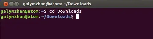

I've selected "Replace initial title" setting in gnome-terminal's preferences, but it just shows the default title "Terminal". After reading this answer, I added this to my .bashrc:
PROMPT_COMMAND='echo -ne "\033]0;${USER}@${HOSTNAME}: ${PWD/$HOME/~}\007"'
and also commented out this line:
#PS1="\[\e]0;${debian_chroot:+($debian_chroot)}\u@\h: \w\a\]$PS1"
After restarting terminal, it started to show user@hostname: ~/currentdir in its title, changing it whenever I cd to another directory. But it still does not change when I launch CLI programs like cmus and vim (vim, for example, sets current filename as a title).
I've installed rxvt and everything works fine there.
Ubuntu 13.04, gnome-terminal 3.6.1.
My .bashrc - almost the same as shipped with default ubuntu installation.
Screenshot of terminal

First, you have something contradictory in your question. You said, "it started to show user@hostname: ~/currentdir in its title, changing it whenever I cd to another directory", but the image attached said something else. I am almost sure that if you've selected "Replace initial title" setting in gnome-terminal's preferences and if you use this ~/.bashrc file as you said, your terminal should look like in the following image:
galymzhan@atom

  • I posted screenshot before modifying bashrc, sorry for confusion. Anyway, those lines 11-40 were indeed the cause of this problem. They are needed to set correct xterm variable (like gnome-256color), but for now I'll stick with default `xterm` value. – galymzhan Aug 09 '13 at 12:52

  • I did everything as you described and still no luck. By the way, is it possible to be a unity issue? I've added screenshot to the post – galymzhan Aug 06 '13 at 04:50
  • Do you use Unity? Personally do and it works and always has. At this point, all of the additions to your .bashrc have probably affected the output in ways that are not as normal if you are using the method described. Further editing is likely to compound the issue versus using the standard, out of the box configuration. One way to test for certain: create another user, try the method described above and see if it works. – freecode Aug 07 '13 at 15:13
