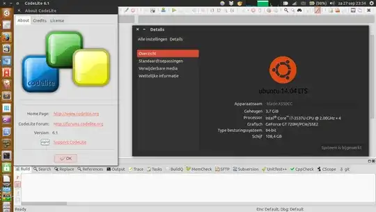

Screenshots
14.04, with latest codelite
codelite 8.1.0, Ubuntu Tursty tahr, 14.04
14.04 codelite 6.1 Ubuntu 14.04(amd64)
12.04 codelite 5.2 Ubuntu 12.04(i386)
13.04 codelite 5.2 Ubuntu 13.04(amd64)
13.10
codelite 5.2 Ubuntu 13.10(amd64)
