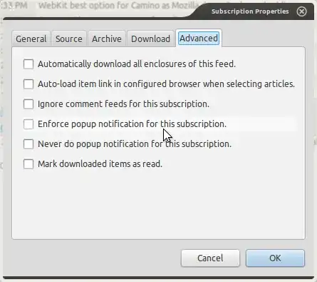

It's a bit strenuous if you have a lot of feeds, but when you select a feed (you have to do this for every single feed), click the Feed Menu, or right click to get the context menu, click Properties, and then select the Advanced Tab, and click the option to ignore comment lists.

  • The lifehacker thread was the one that slowed down the most, so this was as easy fix. Thanks! (Btw. what Theme is that you have there?) – Martin Ueding Apr 04 '11 at 11:28
  • @queueoverlow: Glad it worked for you ^^! I have a mix of themes in that screenshot: One is the emerald theme for the "A New Hope" with a modded button order, and then a theme called Soothe with the selected items colour changed. I think I was using a faenza theme with it as well. – RolandiXor Apr 04 '11 at 14:43
