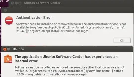

aptitude is not installed, and when I start Ubuntu Software Center it tells me New software can't be installed, because there is a problem with the software currently installed. Do you want to repair this problem now?, when I click Repair an internal error appears:

  • I can't install `aptitude` nor `synaptic` nor anything. Also, Ubuntu Software Center won't start (internal error, added screenshot). – Nicolas Raoul Sep 17 '13 at 07:23
  • I remember I had the same problem. Have you tried building and installing aptitude from source code? [link](http://aptitude.alioth.debian.org/doc/en/pr01s04s02.html) – thanmai Sep 17 '13 at 07:26
