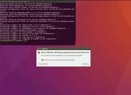

Just for kicks, I went in after a reboot and ran sudo apt remove --purge firefox* libreoffice-* unity* which I would not normally advise doing because it removes some useful programs and puts the system in what might be a less than desirable state!
screenshot broken
The system wouldn't even shutdown properly from the GUI. So how does one fix this? Reboot!
screenshot rebooted
Upon rebooting, everything was back in order. Firefox, LibreOffice, and Unity were all back where they belonged.
