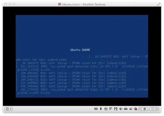

When installing Ubuntu GNOME 13.04 from an ISO in Parallels, I get the following error:
BUG: soft lockup - CPU#0 stuck for 22s!
This is shortly followed by another message:
INFO: rcu_sched self detected stall on CPU
a screenshot of the installation screen displaying the errors
Is this error the result of a problem with the Ubuntu disc image or something else? How can it be fixed?
Note I have checked the integrity of the disc image and checked the disks for defects. No problems were detected.

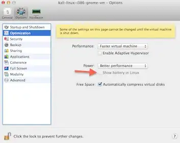

Uncheck the "Show Battery in Linux" as shown in this forum:
https://forums.kali.org/showthread.php?71-Parallels-Desktop-7-Installation-(BUG-Soft-Lockup)&p=3642&viewfull=1#post3642
